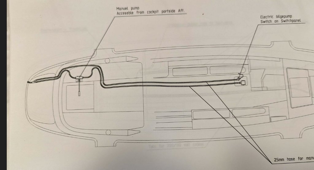

Hello--I'm the happy new owner of a 920 that does not have any bilge pumps installed. I'd like to install a manual (whale type) and an electric, and am interested in where/how other 920 owners have installed and routed their pumps, hoses, and discharge thru-hulls. Under the inspection hatch in the sole on the port side of the centerboard seems like best spot for the electric pump and the suction end of the manual pump hose. Thanks in advance for any advice; having fun getting her ready for launch!

Re: Bilge Pumps
Hi Sam.
The layout is actually in the schematics of the manual. Hope the attached helps.
Cheers
Mark

Re: Bilge Pumps
Thank you; very helpful.
