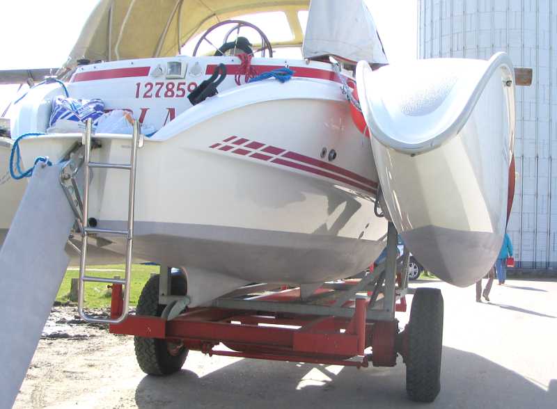

Is it possible to use a drying mooring with a DF1000?
Does the propeller need to be kept off the bottom at all times or is it recessed above the bottom of the hull?
I am in the market for a DF 1000 and need to specify the mooring type

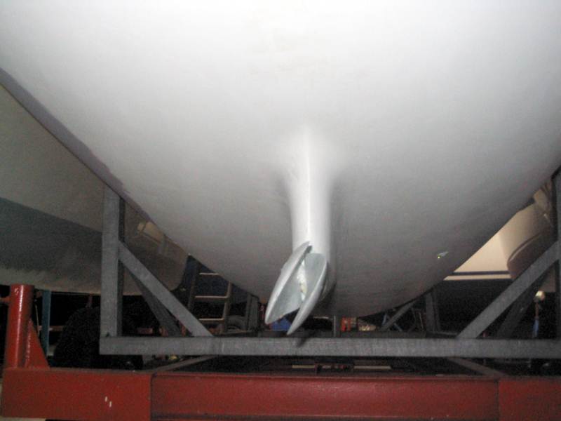

Johnt wrote:Is it possible to use a drying mooring with a DF1000?
The propeller shaft is almost the lowest part of the bottom, just 10mm above the skeg. Please take a look at attached photo.
I do not know is it possible/wise/recommended to use a drying mooring, but anyhow the bottom needs to be soft, no rocks etc and flat. Here in Finland we do not have any tide at all, so I am not familiar with this topic.
By "drying mooring" I assume you mean a mooring field anchorage that dries out at low tide, leaving the boat on mud or sand; and not a dock that mechanically lifts and supports the boat on a cradle designed for the boat?
I strongly advise against it. Beaching the boat is great for pictures in marketing literature to illustrate shallow draft capability, but not good for your bottom finish. :wink:
The propeller is recessed above the bottom of the hull skeg, but not by a lot, and the skeg provides some protection but is narrow. All Dragonflies built by Quorning have solid fiberglass along the centerline strip of the bottom for about 1-2 feet wide, and the lowest areas are quite sturdy, but most of the hull areas are foam-cored with thin skin to keep the boat light. It can handle a gentle grounding and drying out, and the solid areas will handle it better, but the following cautions apply:
1) It must be a protected area with no wakes or long "fetch". If there are waves and the boat is not "hard aground" (mid-tide?), it could cause repeated pounding against the bottom resulting in eventual damage.
2) Rocks, gravel and shells could cause high point-loads that scratch and damage as the boat moves, could jam in the centerboard slot, or cause damage to bottom skin/core.
3) If the bottom is uneven, or is very soft so the hull sinks deep in mud or sand, or if there is a boulder that protrudes up -- damage to the shaft or prop blades is a possibility.
4) Sand and gravel stuffed into the centerboard, cutlass bearing and shaft tube at start of every use will likely cause premature wear.
5) For ANY boat, your (expensive) anti-fouling paint will not last.
And lastly, you will be restricted by the tides so you won't be able to come and go when you please.
tpaliwoda
Posts: 215
Joined: Fri 03 Nov 06, 3:05
Your Country: USA, Raritan YC, Perth Amboy, New Jersey
Post by tpaliwoda »
Larry is correct with all his points.
Look for a place to keep it that has water all the time. It can float in very little water, just make sure you keep the rudder and centerboard up when you put it away.
