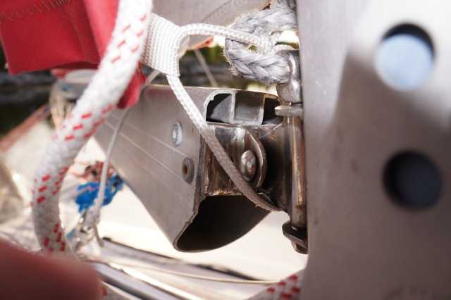

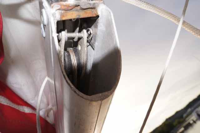

Also I don't find any sheaves in the front side of the boom. Can anyone post pictures of how it should look?
This is how it looks on my boat:
Image Image

Updated with images.
