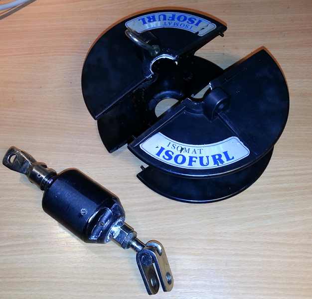

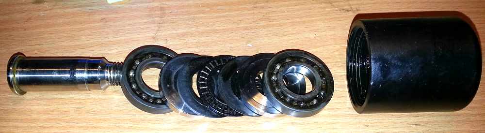

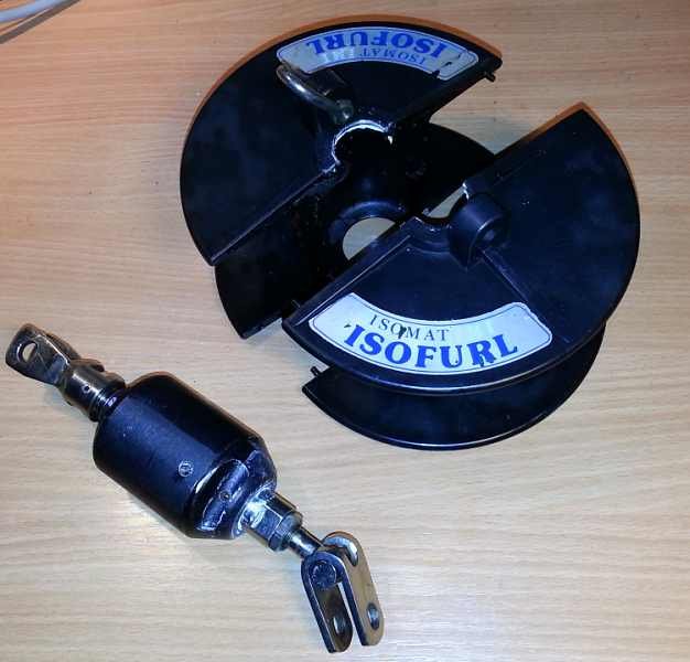

Now I have repaired the furler (top).
It is a product Bartels.
For photos using the link:
http://fotos.gottlieb.at/thumbnails.php?album=53
If you have the same furler that I can give the name of the ball bearings here you can see on the photos.
1x AXK 2542 SKF Axial Nadelkranz
2x AS2542 SKF Axialscheibe
2x 16004 SKF Rollenkugellager
I also have the lower side of the profile decomposed to conduct a comprehensive inspection.

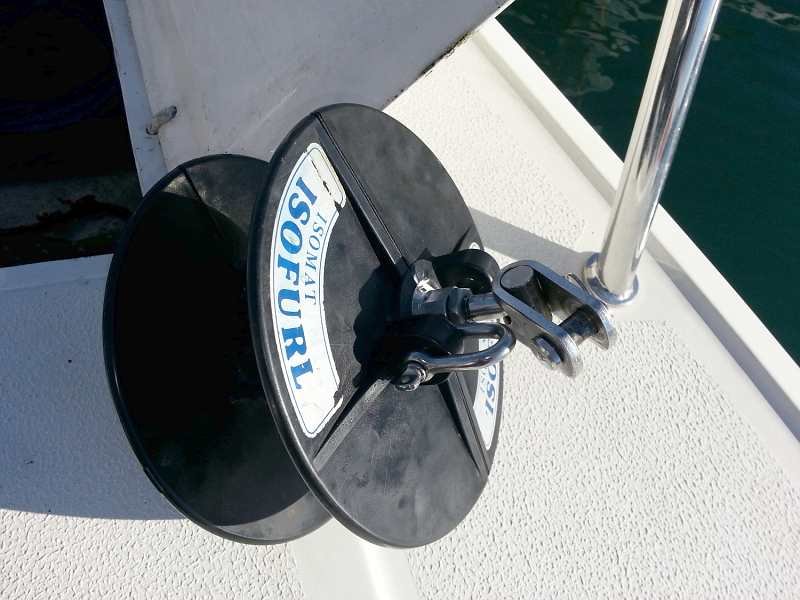

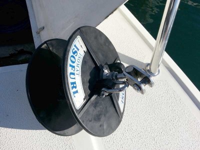

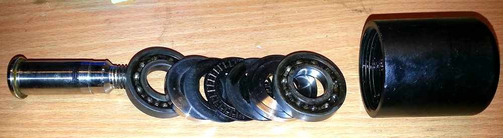

The furling drum and bearing case is back on the boat (DF SW800 No. 163 - 1990).
I bought the parts (same as described above) and made the exchange. You only change the bearings, two solid rings are reused at the same place and position.
Great improvement, might need now to do the same on the top bearing when I lower the mast next time.
Three pictures:
- the furling drum on the deck (not shown, mast secured with two halyards)
- the furling drum open with the bearing case
- the parts inside the bearing case
Three pictures:
- the parts inside the bearing case-
