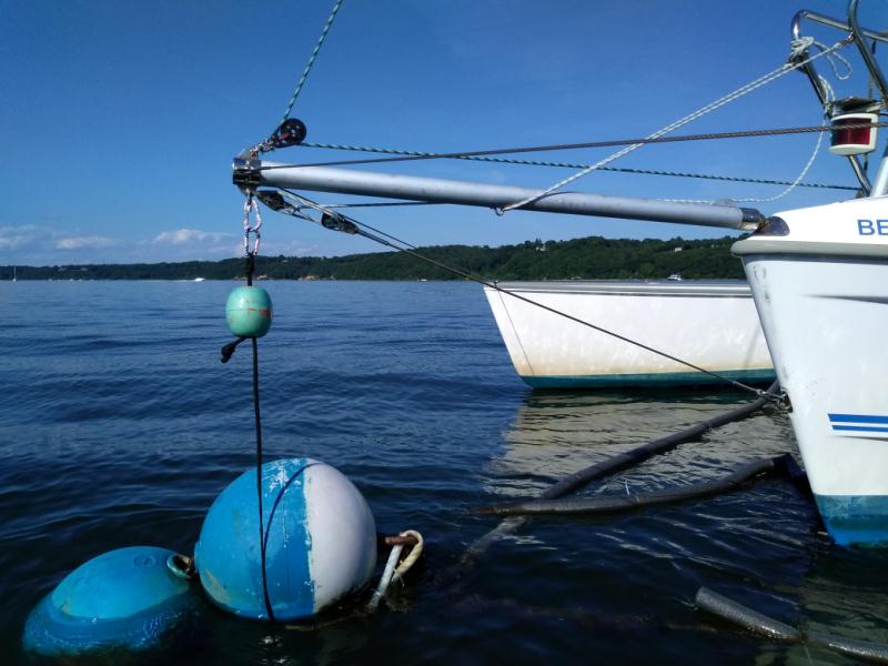

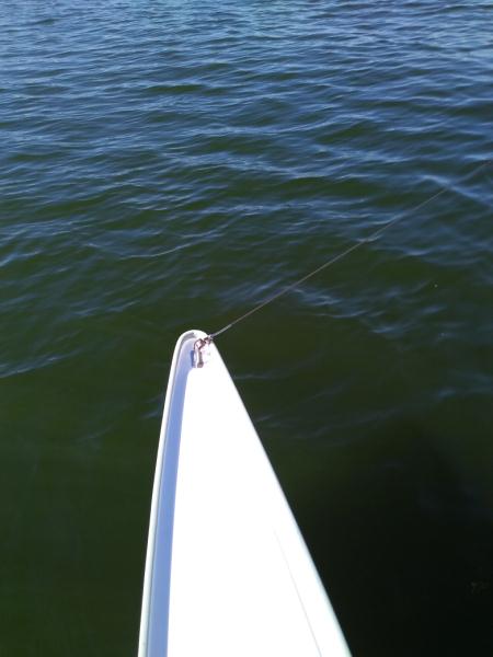

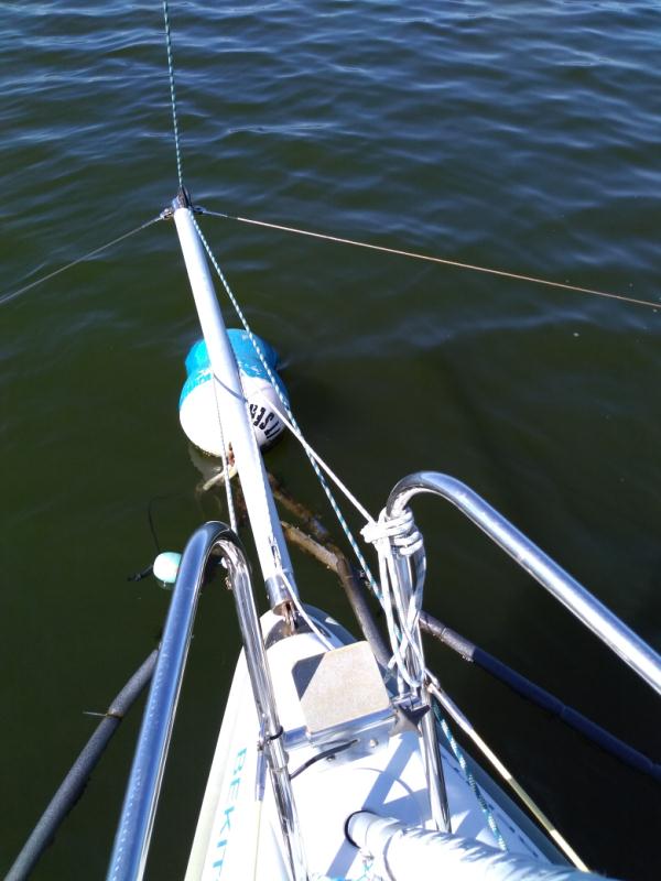

I took a bunch of pictures of my bow sprit today. I will email them to Bo so they will be posted in a couple of days. I can then walk you through the setup.
Image Image Image Image
gminkovsky
Posts: 214
Joined: Wed 01 Nov 06, 19:58
Your Country: USA, Long Island Sound
Post by gminkovsky »
So here are the comments:
as you can see, there is 1 wire stay connected on each side of the tip of the sprit to the eye on each ama. The geometry is such that it allows the sprit to be raised and lowered.
there is a stay that connects to an eye low on the bow, then via blocks and rope to the tip of the sprit. the line then goes through a jam cleat and up to pulpit. use this to tighten the sprit in low horizontal position or loosen it to raise the sprit.
there is a line that goes through an eye in the middle of sprit underneath and is connected to 2 small eyes on pulpit with snapshackles. Keeps the sprit from falling down.
