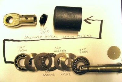

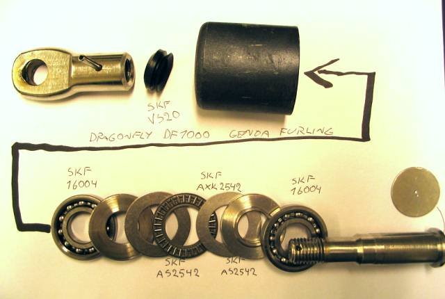

My furling system top bearing was not working properly and finally it jammed totally. The seal of top bearing unit was broken and upper bearing was full of rust and did not rotate at all. There is possibility to get the whole rig down if the thread between upper and lower part of the bearing box opens while furling. If you need instructions and spare parts list please send me an email.

My bearing set was also assembled upside down. The stainless steel rings between bearings were not taking the force from inner lower ball bearing ring to the outer upper ball bearing ring. I do not know has it always been like this or not.

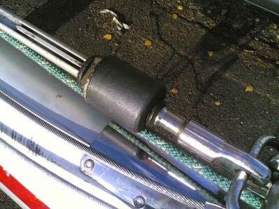

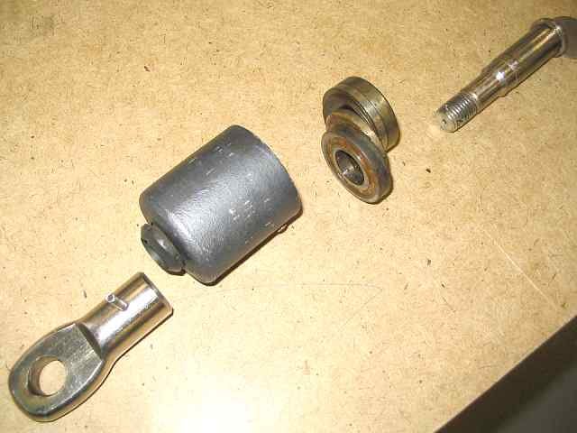

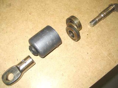

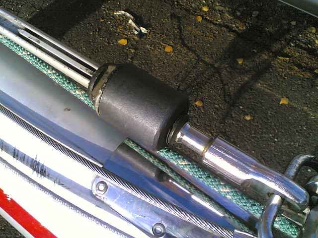

Top Furler Fixing Instructions
I've now added the photos to Mika Harju fixing instructions.
Thanks for the photos and part numbers!
Recently, I took down the forestay and found the same thing, an improperly placed thrust bearing. The grease was mostly gone, the top bearing was really bad and rusting, the lower bearing was better due to having more grease, but was still in need of replacement, and the thrust bearing was somewhere in between. I ordered replacement roller bearings, but was unable to find a part number for the thrust bearing. Being that I've reassembled it (and added a couple more set screws to the housing for good measure) I'll try it out with the old thrust bearing.

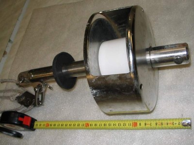

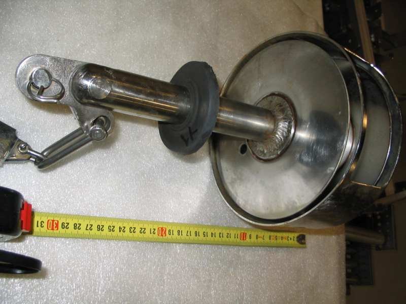

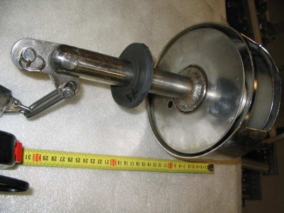

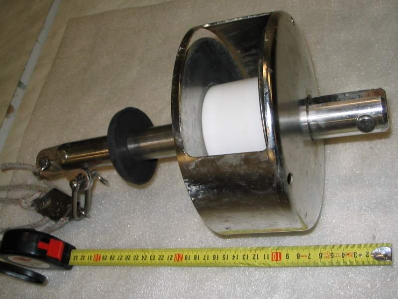

Atttached you'll find a couple of photos of my furler. I hope these help you. This is Bartels Standard IV.
and the pdf file :
and the pdf file :

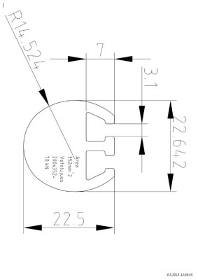

The upper swivel body is assembled by using glue to prevent it to opening. Use heat to melt the glue and if necessary you need to use plumber's tools to open it. You'll damage the surface then but there is no options if force is needed to open.

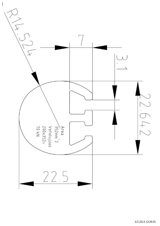

I replaced the original Bartels system about 10 years ago with one-off design by myself. If you're interested I could advise you to build one too.
A couple of 3D Cad screenshots:
( Bo will add these)
