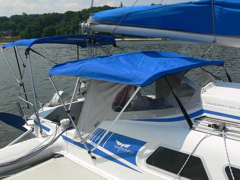

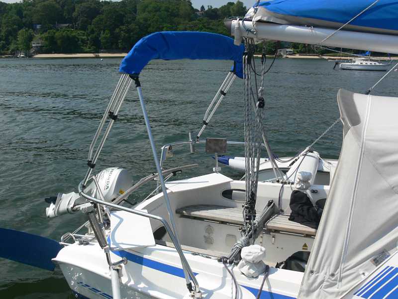

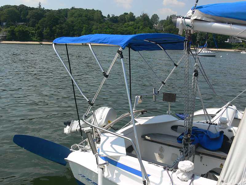

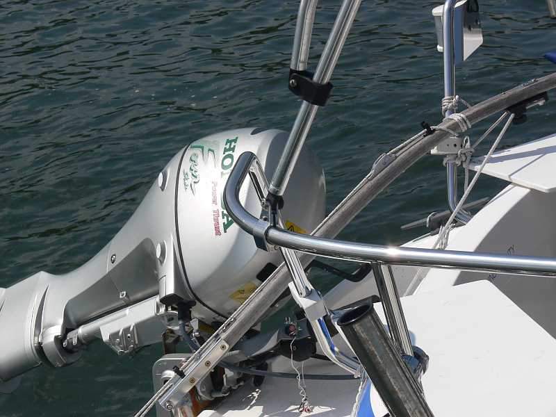

I am very concerned about UV exposure, so I fitted 2 biminis on my 920. The primary bimini is 4 feet (120 cm) long and is mounted on aft rail at about the middle lengthwise. The bimini is a standard size purchased from a marine store in the US. In the open position it reaches to just aft of the end of the boom in the front and overlaps the swim platform in the back. It provides enough shade for a sitting or standing helmsman except when the sun is low. (It is mounted higher than the lowest boom position.) I used 2 bimini jaws that open up to mount the center support on the rail. I used 2 other jaws that open up to mount forward support poles on the forward base of the aft rail. The four jaws that open up and the two forward support poles are as expensive as the rest of the bimini!

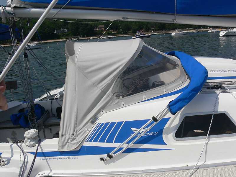

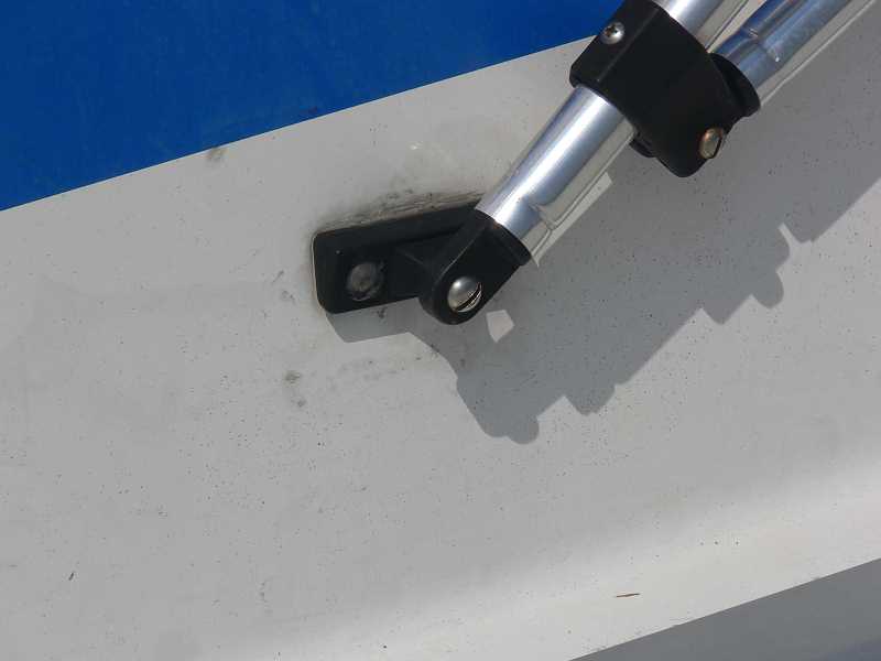

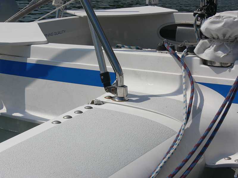

I mounted the second bimini on the sides of the main hull just forward of the cockpit. It is also a standard size bimini - 6 foot (180 cm) long. This bimini opens up to reach as far back as a main sheet, and just forward of the companion way hatch. In height it is just above the dodger so it clears the boom in the lowest position. This bimini provides excellent protection for the cockpit and cabin. However, it is difficult to use during sailing because is is so low. We usually use it at anchor or if motoring.

Notes: the explanations are in the file names - difficult to read.
Here they are:
1. Aft bimini closed
2. Aft bimini forward support (attached with an opening jaw to the aft rail)
3. Aft bimini open

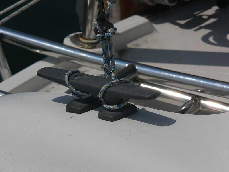

4. Aft bimini rear strap (attached to aft mooring cleat)
5. Aft bimini rear support (attached with an opening jaw to the rail)
6. Both aft and forward bimini open

8. Forward bimini closed

10. Forward bimini support attached to the side of the cabin
