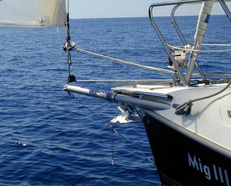

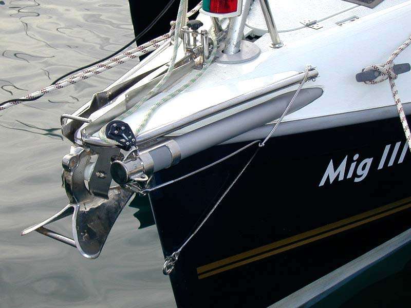

June 2002 i attached an bowsprit with anchor fitting and roller at the bow of my DF920R-57, see the pictures in the old forum (24. June 2002 ).

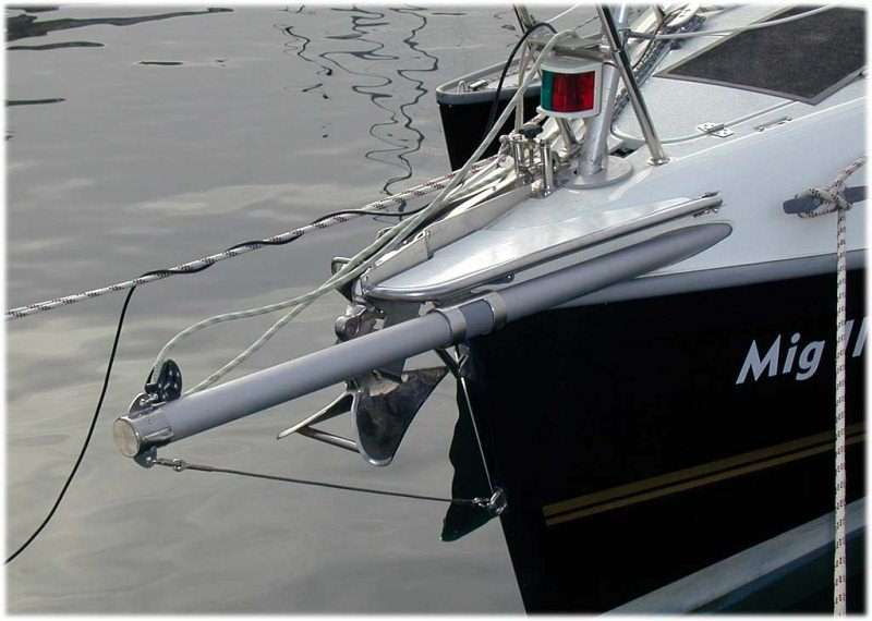

Since that time I wanted to build an retractable Gennaker – boom as the distance between original Quorning bowsprit-fitting and new fitting at the front end of the bow-platform is merely 30 cm. The boom should be retracted in the anchor-locker and pusched out for Gennaker-sailing. But cutting a hole in the fuselage caused me headaches and so I did this only several years later.

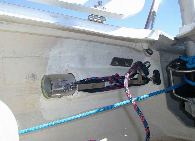

As seen in the pictures a stainless steel hose is fixed at the bow platform. Drilling the opening for the boom I did in two steps: First a pilot-whole with a very long drill ( > 80 cm), guided at the shaft by a wooden fixing, then cutting the hole with a key-hole saw, see picture, the hole saw guided by the long drill. Inside the anchor-locker a tube is laminated, reinforced by an stainless steel ring, all laminated to the inner fuselage wall. The boom can now pushed in and pulled out easily by a tackle with cam-cleat as seen in the picture.
The length of the boom is limited by the rear wall of the anchor locker, the effective/usable length of the boom is about 90 cm, measured from the original Quorning fitting to the front end. You could use a longer boom but then an additional hole has to be cut in the rear wall of anchor locker and the boom would reach into the cabin ( locker over the front berth). I didn’t do this and I’m satisfied with the relatively short boom.
The front- and end- fittings of the boom are the original ones from Quorning.
